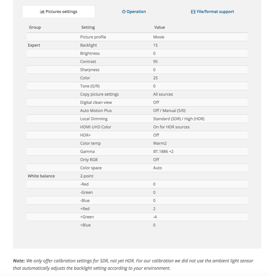

Os paso unos settings para las Q9FN que os pueden venir bien.
Picture Mode: Movie
Picture Size Settings: 16:9 Standard
Fit to Screen: On
Expert Settings
Backlight: 8 (Max)
Brightness: 0
Contrast: 45
Sharpness: 0
Colour: 25
Tint (G/R): 0
Apply Picture Settings: All Sources
Digital Clean View: Off
Auto Motion Plus Settings: Off
Local Dimming: High
Contrast Enhancer: Off
HDR+ Mode: unticked
Film Mode: Off
Color Tone: Warm2
White Balance
Gamma: BT.1868
BT.1868: 1
RGB Only Mode: Off
Color Space Settings: Auto
Picture Mode: Movie
Fit to Screen: On
Expert Settings
Backlight: 15
Brightness: 0
Contrast: 95
Sharpness: 0
Colour: 25
Tint (G/R): 0
Local Dimming: Standart (SDR) / High (HDR)
HDMI UHD Color: On for HDR
HDR+ Mode: unticked
Color Tone: Warm2
White Balance
Gamma: BT.1868 +2
BT.1868: 1
RGB Only Mode: Off
TV Settings Samsung Q9FN (Q9F)
Samsung Q9FN Calibration Settings
